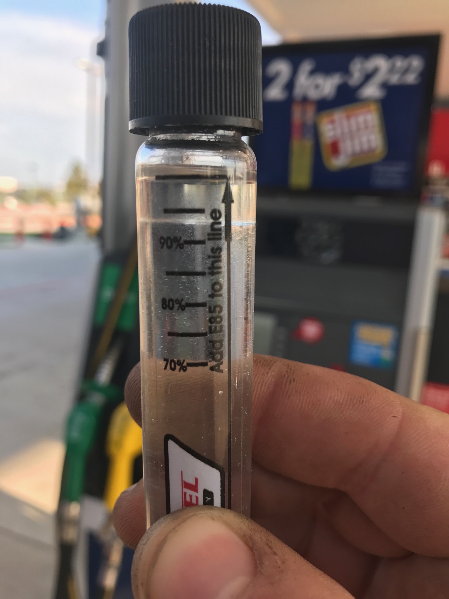

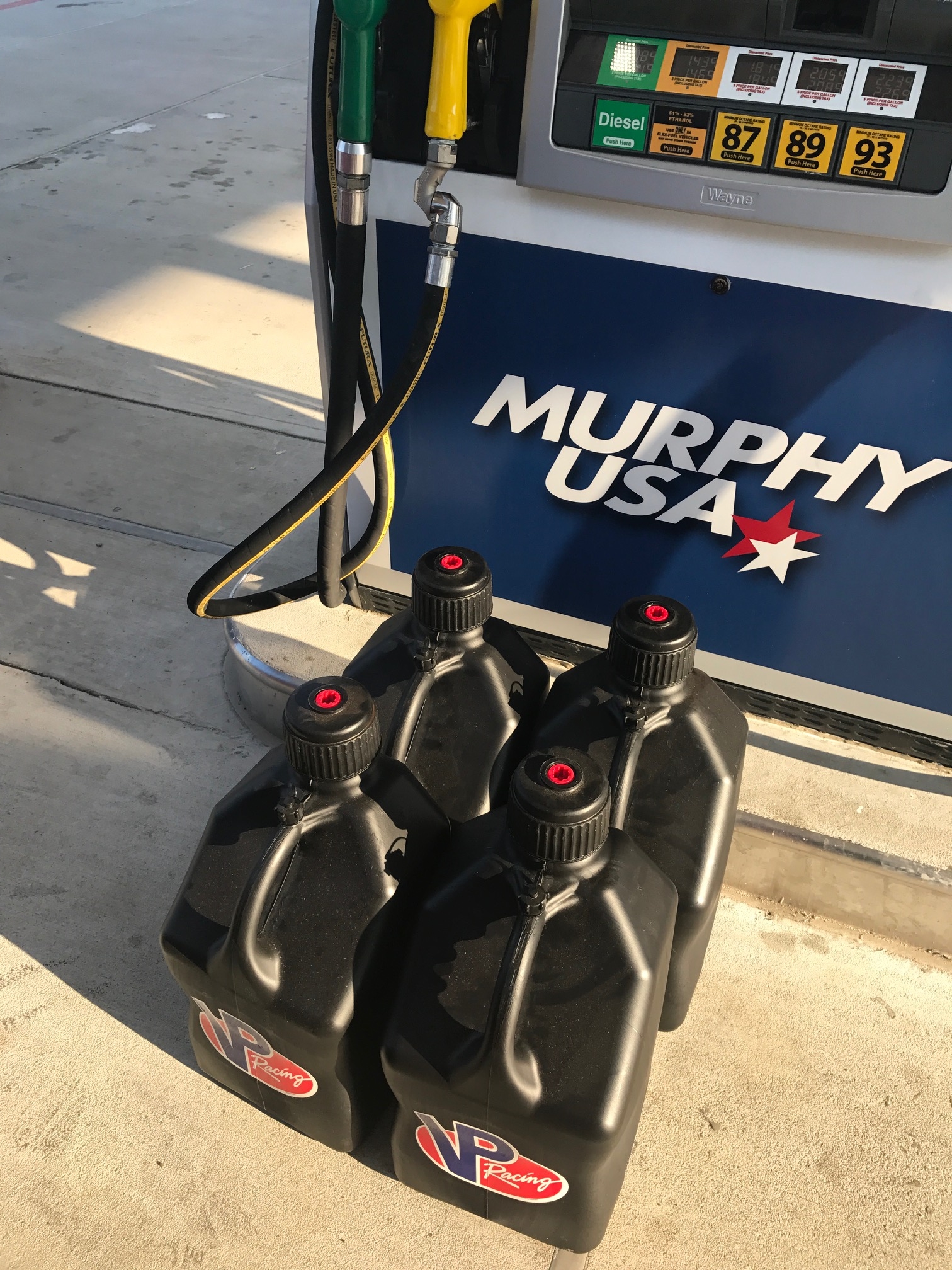

Filled up last week on E47, the quality of the fuel at my station down the street from where i live is the best I've ever seen, E90 or above lol.
So far the tune is on 23* timing, and .87 lambda on a base boost of 25psi to start with the injection start angle tuned a bit earlier. Im making sure the fuel trims are settled in and the fueling is 100% before turning it up little by little to pay close attention to fuel pressure and injector DC and injector timing. I have the stage 2 cams and opels, I'm not sure how far that will take me on E47, hopefully up to 28-29psi, maybe, we'll see. The 5th injector is just there if i need it, but not active as of now.

I found a gas station that tested 90%, I was tickled. Then I tested some flex fuel from my local chain, which should test 51-83% and is labeled as such, but it also tested at 88%. It seems all I've been testing is up over prior years.
We are also talking about summer gas which should be very high ethanol content. Winter is the bigger issue when it drops to the 50-75% range.

Yes, I checked my local station in Feb or March when they first started carrying the "Flex Fuel", note, it doesn't say E85, it tested at an even 70%. Even so being the mix is higher in summer, the 88% was a welcome surprise. I have an on board E tester also using a flex fuel sensor which is nice for keeping tabs on the status of the mix in my tank.

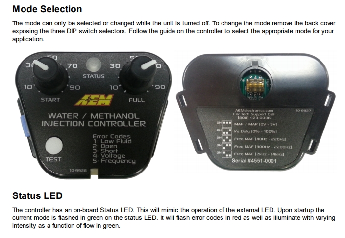

Well since ZZP won't sell me just a fuel controller instead of the entire kit...........fine....
So for future bc I know I'm going to need the 5th injector eventually. Testing with my old style AEM meth controller, it actuates the deka 630cc injector just fine. It may not be an ideal pulse width but it works and I'm gonna try it out.
Going to tap into the MAF signal wire via ZZP's MAF extension harness and run it to the AEM controller in the cabin. 4000hz to 14000hz is plenty of adjustement, have it come in around 8500hz (15psi on my logs) and full around ~12000hz (max i've seen so far in my logs). This should make tuning it quite easy rather than relative pressure controllers (boost pressure).
So i bought this, gotta wait for Amazon now:
