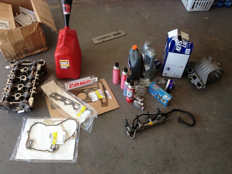

Parts pile

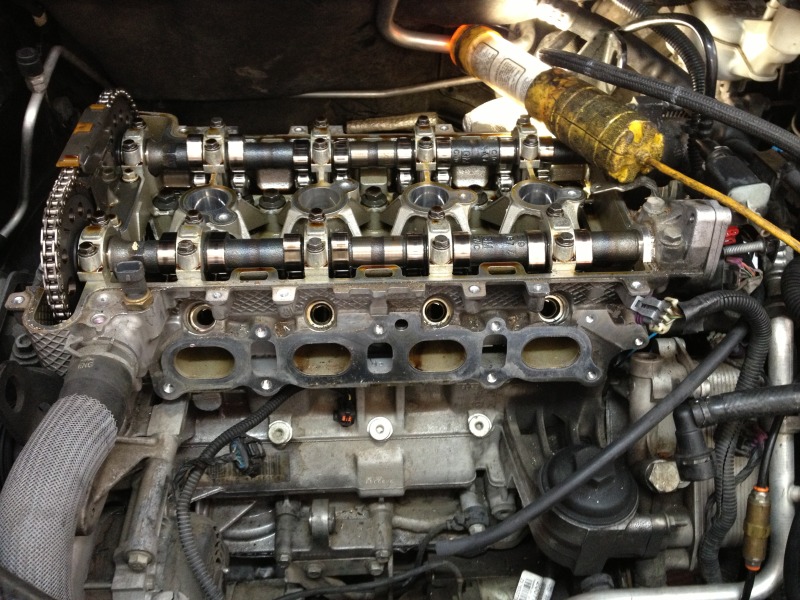

Removed IM and valve cover next

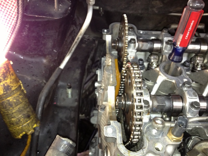

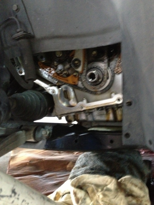

Off with the timing cover

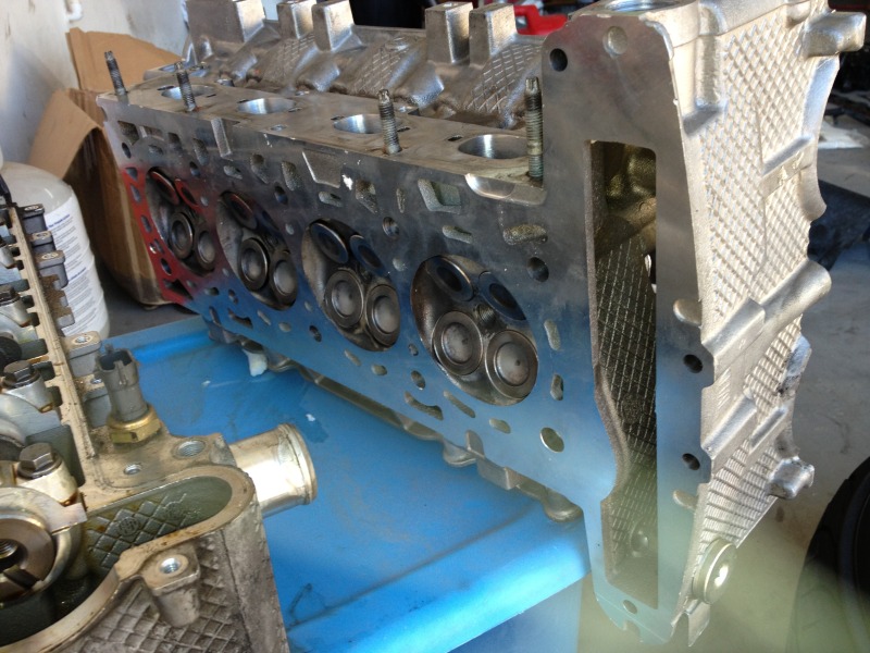

And off with the stock head. We got lucky and were able to wiggle the ZZP LTH off without having to remove it.

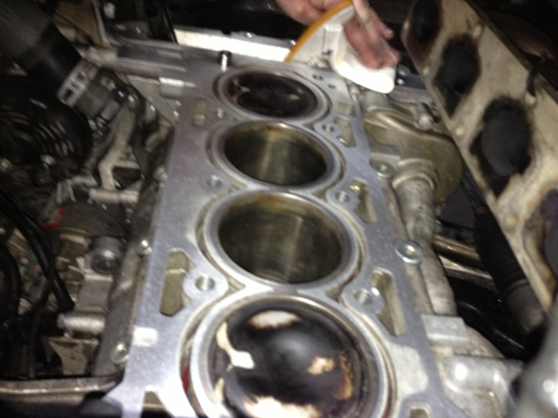

Cylinders looked great!

Time to time it!
