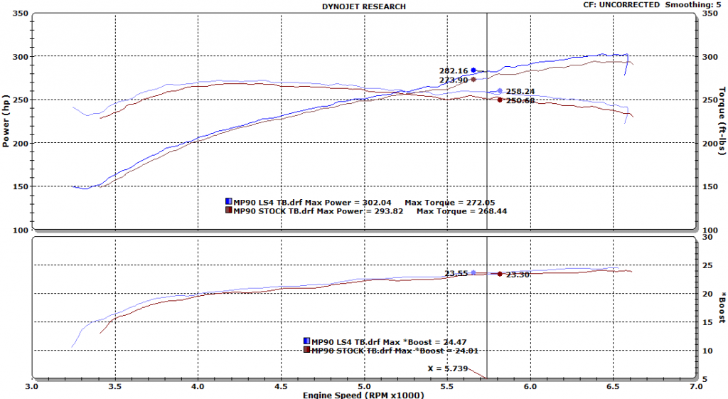

Originally Posted by Fidget
Is it worth upgrading to LS4 throttle body with a tvs with a 2.8 pully running a griffin and dual pass? I have one but never installed it.
For your viewing pleasure
$50-100 part
Bolt on, change scaler to 4950 and adjust fuel trims via MAF/VE
9whp gain @ peak
4ftlbs gain @ peak
More power under the entire curve

how the heck do you get more power under a curve that reflects peak power?. Folks talk about this here like its pixie dust.
its bs.
peak torque and power was increased by an amount that is probably statistically as valid as the dyno variation due to ambient conditions.

Fidget, stay away from the LS4 tb unless you have a high threshold for pain.
its bs.
If you increase torque, hp follows suit. Over the entire powerband, it's evident torque increased; it's obvious past 5250 RPM.
Dynoed within 15 minutes of one another.
4% change in humidity
STD
UNCORRECTED
MORE UNCORRECTED SHOWING INCREASED POWER THROUGH OUT, NOT JUST PEAK.

All i know is i feel a lot more power with the ls4. My car responds alot faster and more direct.

butt dyno ^_^

My tuner before Rakes said he loved the LS4 (made a good gain) but driveability sucked

to properly do the ls4 tb, you need to change the pedal, and recall the backside of the ecm.
