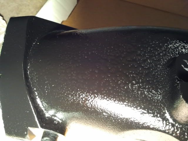

but the paint has a wrinkled look to it. not sure why

60 degrees, but it started to pour down rain right after i started painting it so im guessing the humidity is the problem. but itll do until i can get it powdercoated

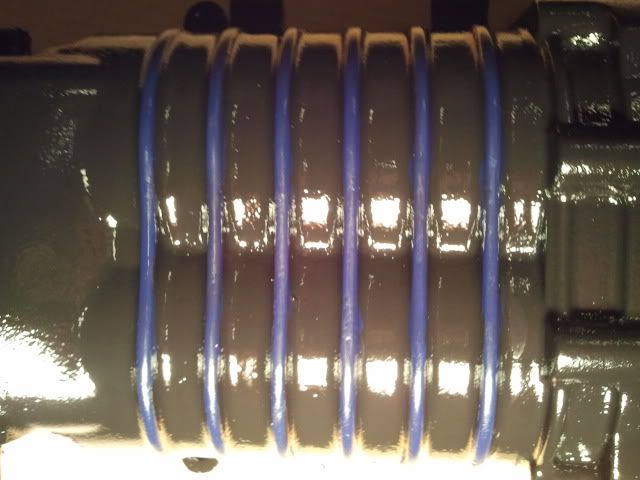

these pictures look like **** compared to what they actually look like, but just to prove that it happened haha
and see what i mean by it looks like wrinkled paint, but i guess its ok because it actually doesnt look horrible.

Those are fish eye's.Happens when the surface is not prepped right or was dirty(oil).When anything fisheye's,lightly dust it with pain and it'll fill in.Kinda like over spray the area till it fills then let it dry.After that you can lay a nice layer on top of it.
