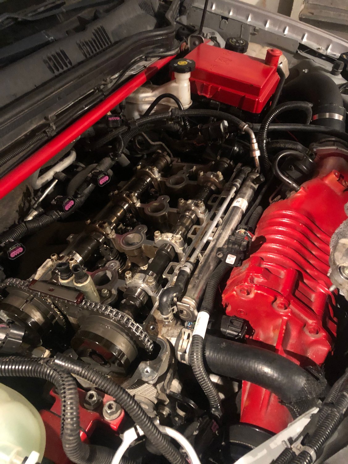

Old Feb 16, 2021 | 06:41 PM
  #592
G5ALIVE's Avatar
Joined: 07-04-18
Posts: 967
Likes: 139
From: Oak Lake
Nothing too crazy happened today. Hands and arms were insanely sore from replacing those little grommets on the valve cover bolts.
My push to connect stem elbows came in!, which just alleviated a clearance issue I was having with the tube going towards my methanol nozzle.
Cleaned the engine up more with engine shampoo and she is looking pretty!
Still have to start the thing up, make sure everything's ok, but I should be good to start looking seriously for my HE leak now.
Radiator leak should be as simply as replacing the rad petcock just waiting for a little warmer day..
Then It should just be validated I have no vacuum leaks, clean up tune, make a pass or add something new!

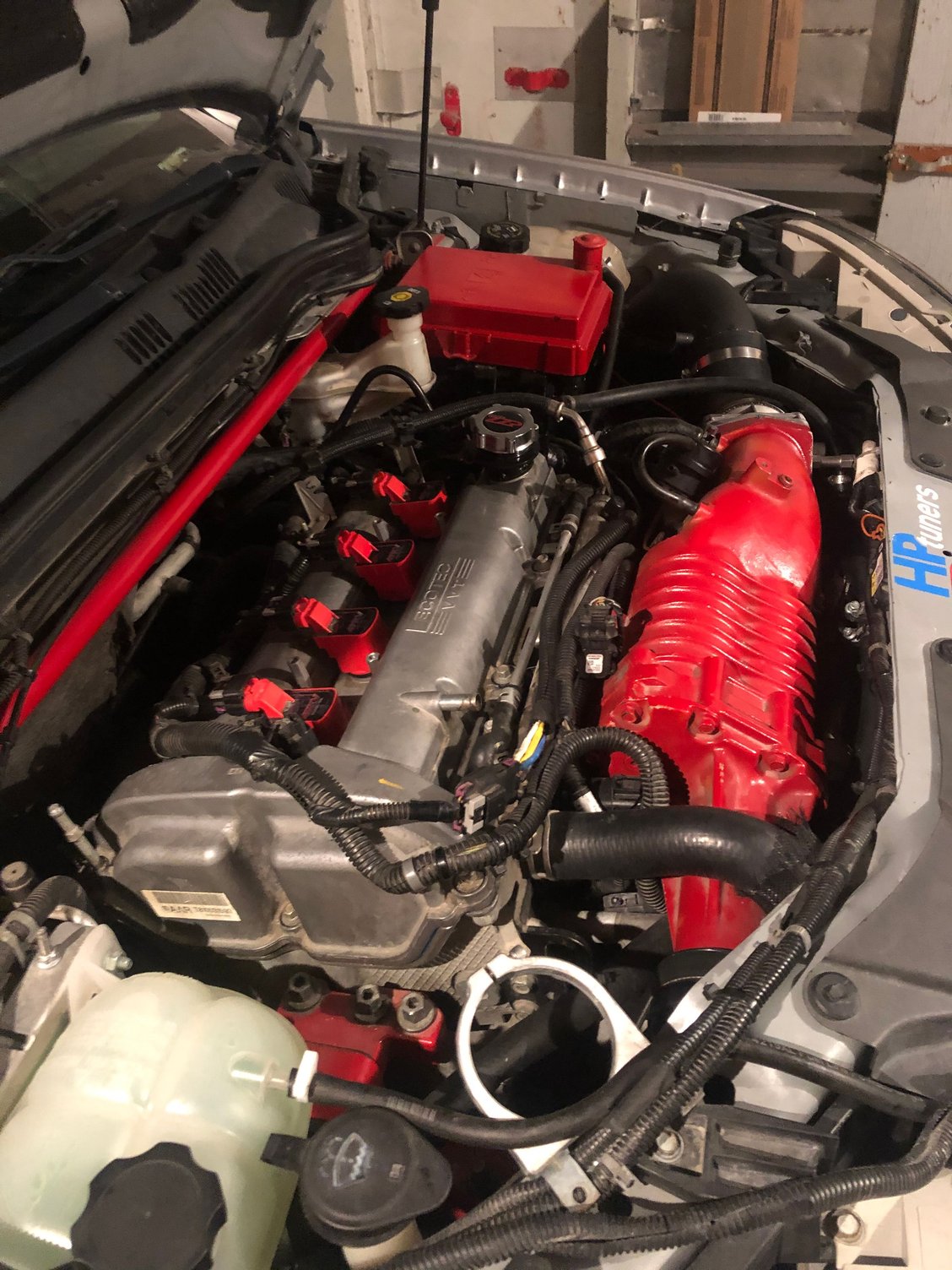

Sorry yes I do have high voltage coil packs, when taking off the valve cover one of the connector/ wires for a coil pack had to pushed out of the way, forgot it was stupid cold out and it made a snap when I moved it a little too quickly.. but it was just the convolute around the wires which made noise, the wires themselves seem fine.

Originally Posted by G5ALIVE
Coil packs shown above.. Pretty sure it was coil connector number 2, pushed it back almost 180 degree's to get out of the way, used a little more force than anticipated made a scary noise but all is swell, nothing got damaged
