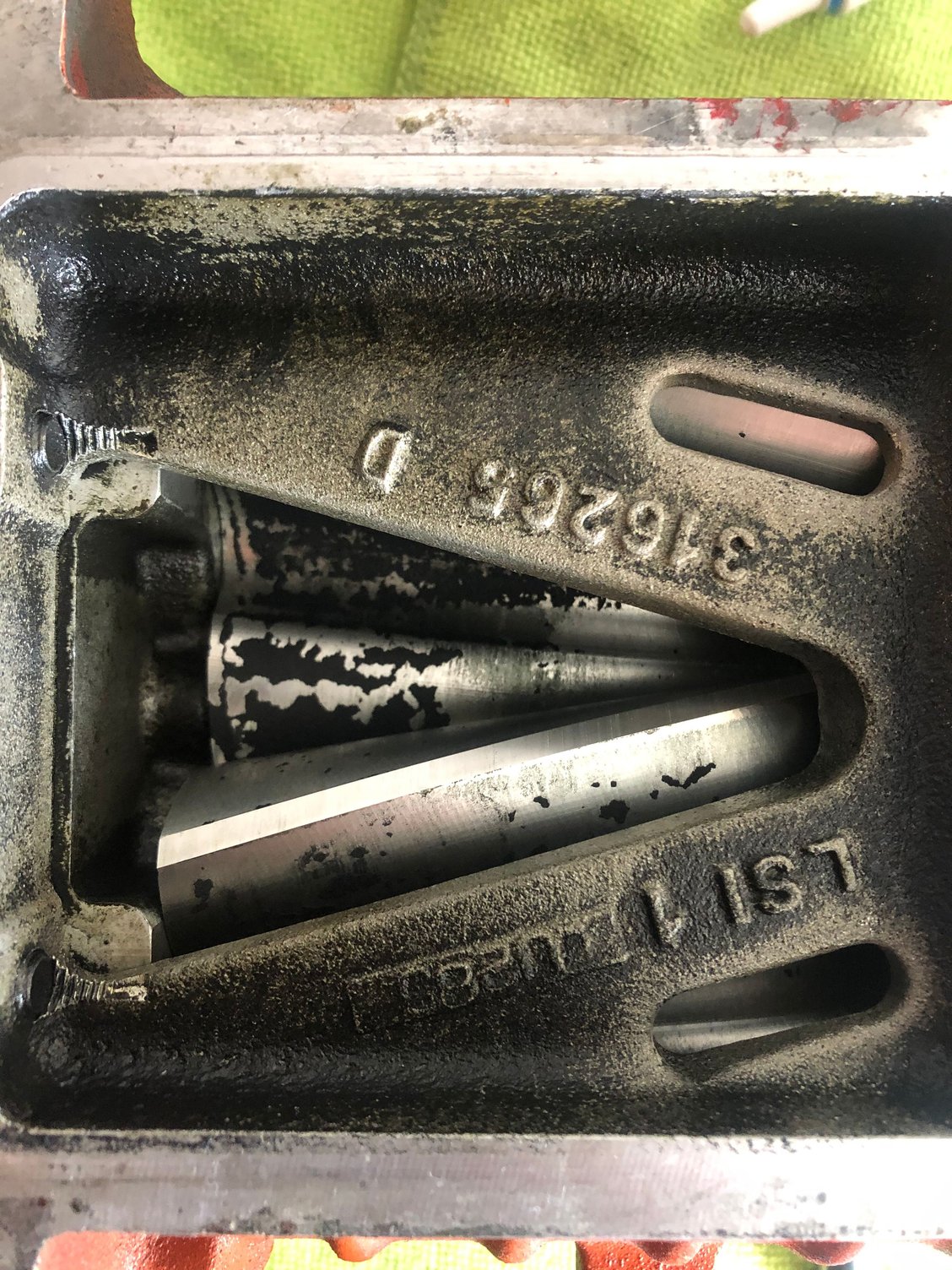

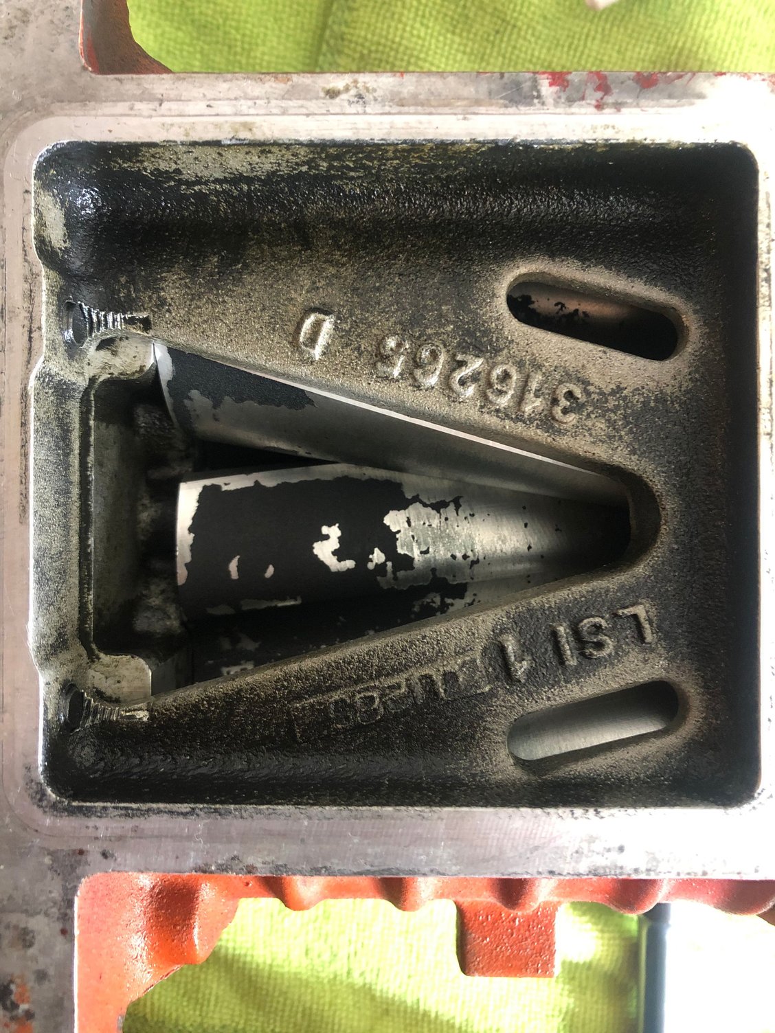

Soo supercharger doesn’t have any Teflon left lol that happened quicker than I expected
Damn Son lol. Looks like you will need a rebuild brotha. I've seen recoated rotors being sold on ebay before. I would try looking unless you are going to do it all yourself. Mine has a few tiny nicks but nothing like yours is. What causes this? Bad needle bearing?
https://www.ebay.ca/itm/Cobalt-SS-Su...sAAOSwB-1Ypi7X
Supercharger itself should be fine it was refurbished two years ago before I got it. That’s what methanol does tho, slowly eats away the Teflon. It should be fine lol, maybe drop to the 2.8 to compensate for it running a little less efficiently
