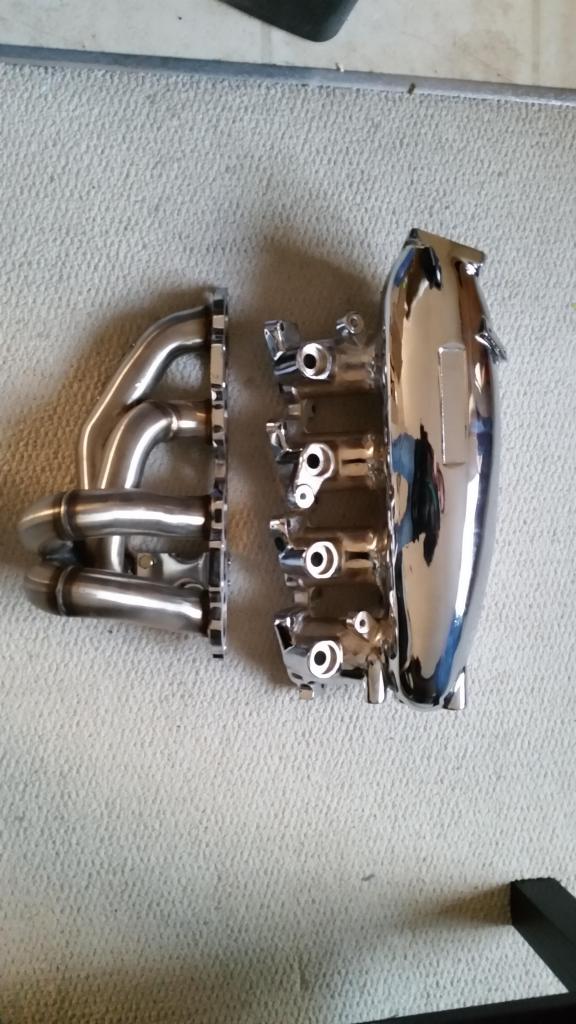

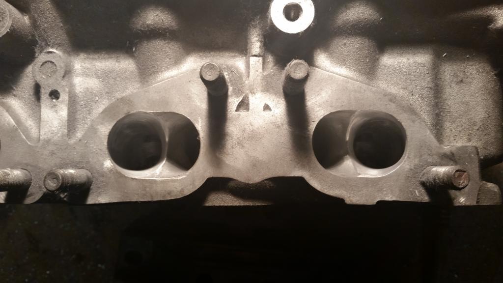

So we finally have parts rolling in for the 240sex

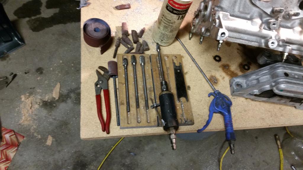

I was asked what tools I'm using to port so here they are... and beer

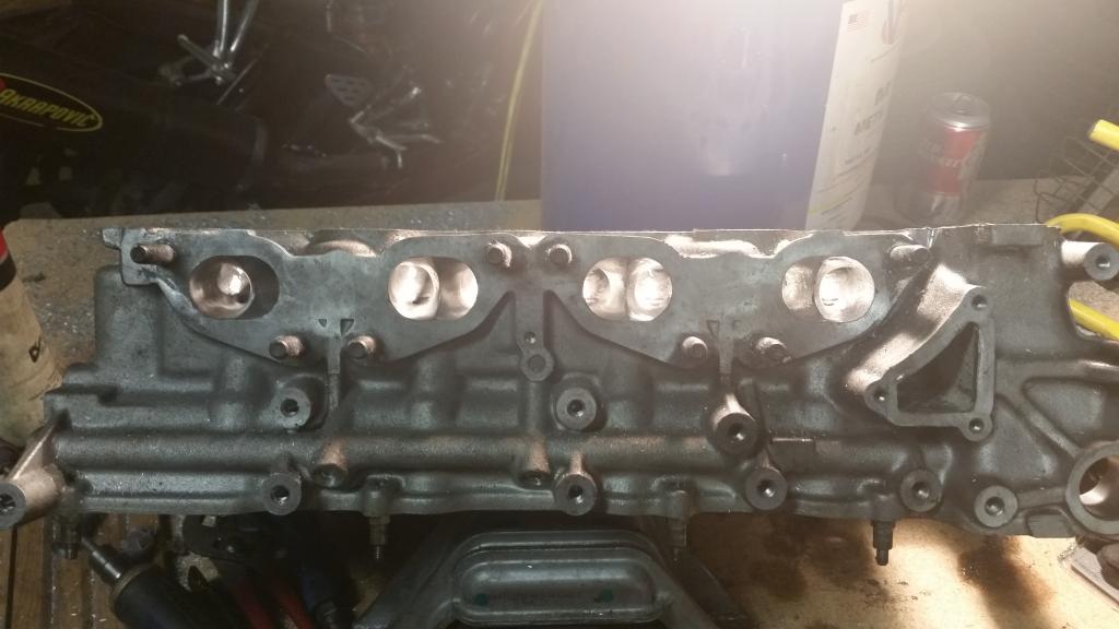

I have a tiny compressor so I'm letting it take a break so this is where I'm at right now

Looks pretty good. No LSJion good but still good none the less

That's not even the finished product **** I didn't update this thread

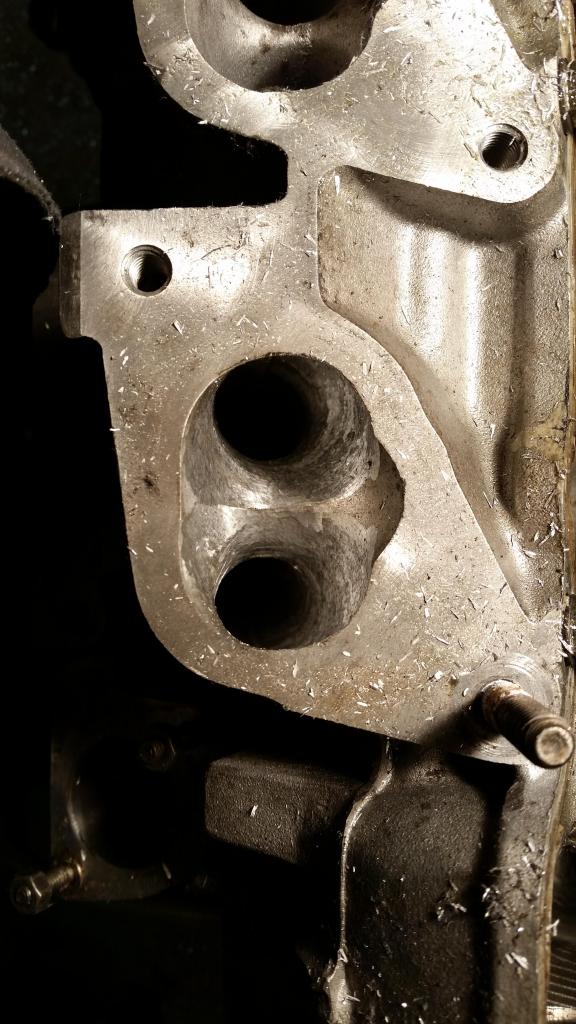

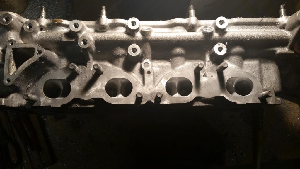

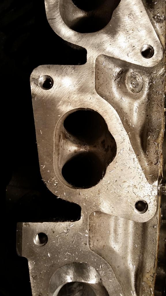

Exhaust side done!!

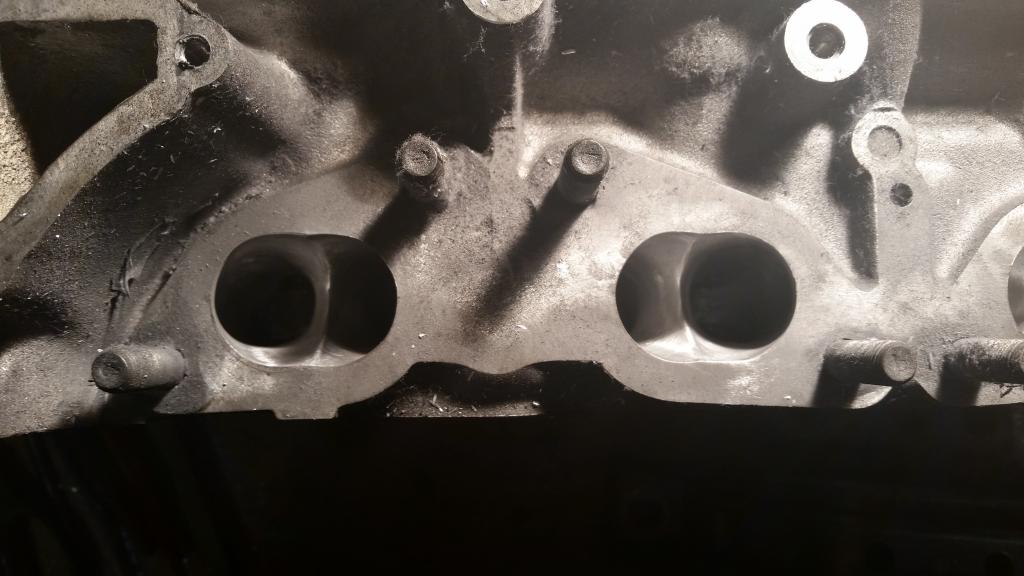

Here's stock intake port

Here's it roughed in I can't find the gasket but by just blending out the stock ports it looks like it gains a bunch. The runners go really deep into the head so I'll be doing just the match and blending between the runners
