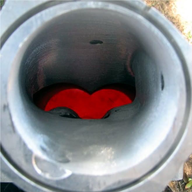

Here's some food for thought.
I had 5+hrs in porting & polishing on the inlet side of this sc. And saw absolutly no change in iat's or in performance for that matter. It wasnt untill I ported the outlet we saw a gain in boost and lower iats. The secret is finding the right outlet port design. If you saw lower iat's it was because of the light porting you did to the outlet. And what you did to your sc was just the tip of the iceburg. Im sure the ported inlet did help when the outlet finally got ported.
Hmmm, very interesting.
Through my research, and what I was told by Eaton.... The outlet is specifically designed for the degree twist of the rotors. If you over port the outlet you can loose pumping efficiency. I wont argue with you though man, because unlike a lot of people on here, you know what you are doing. You must have took the magical amount of material off which still maintains efficiency, but helps bump performance a bit.

My butt dyno agrees with this magical amount of material
hptuners agreed too.. lol
I didn't believe it @ first either. Until we tried about 4 different m62 ports + log after log...
After working for Vortech, I've learned they tell people the superchargers are at their best so noobs don't go and **** their **** up lol And knowing you can pull another 200 hp out of Procharger F3 by improving the volute that they say can not be improved on . I kinda turn a deaf ear to the engineers lol.

Originally Posted by Omnigear
QUOTE=euthanasia;6508544]Here's some food for thought.
[/QUOTE]
There's a reason only 3 exist and no pics of the outlet can be found lol

@euthanasia
mine looks just like yours just ported moar and the tb is port matched =D love the whine its stupid loud
and i ported the hell out of my outlet haha

Its definitely an interesting outlet port design...i think the blower screams less when ported (im quieter than my friends 3.0 M62 and im a 2.9)

There's a reason only 3 exist and no pics of the outlet can be found lol[/QUOTE]
I got a pic lol Top Secret port ftw
