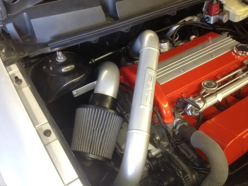

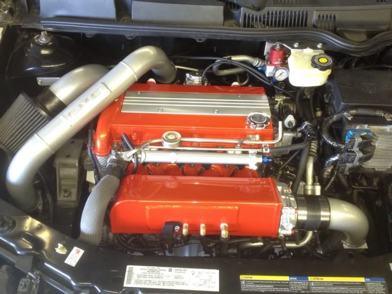

A few pics of my set up
Holy hell thats a clean engine bay!
Also does that say AMS on the piping ?
Old Feb 10, 2013 | 10:47 PM
  #3998
slvr 04 rl's Avatar
Joined: 07-06-09
Posts: 753
From: Houston
Thanks
No it says CMS it's a local shop down here that did my piping.
