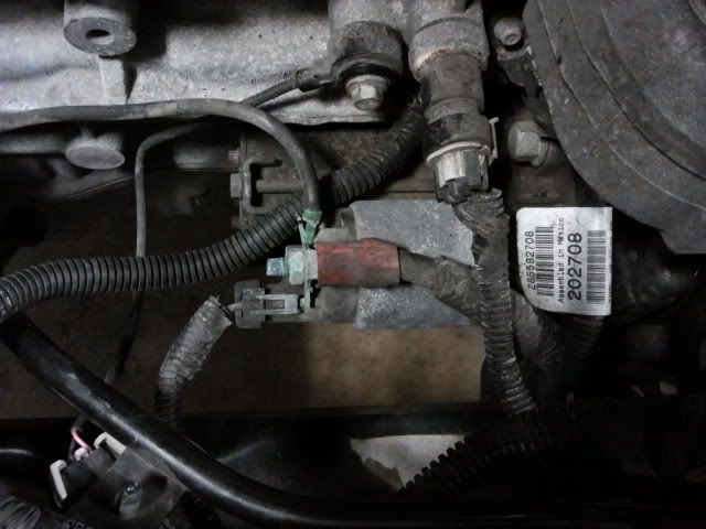

and i noticed that the intake manifold almost fit except for a wire connector thing at the bottom seemed to be getting in the way. anybody know what im talking about? its got a red rubber thing around it

Originally Posted by drumrush
no pics yet because my phone is dead, but i changed my plugs, took off my bumper, took off my IM/TB, rewired my tb harness, installed my new injectors, and test fitted the intake manifold. i would have tried to install it but my lower mount wont be here till tomorrow...
sounds like the positive terminal to your starter, make sure your intake mani doesnt touch that or else youll ground out your car, that was a problem i had

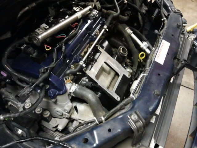

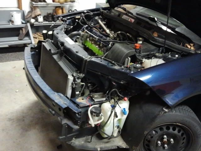

nevermind, i brought the charger into the garage with me and it worked. pic will be up in a minute
and some other fun pictures

yeah thats the positive terminal to your starter, u might be able to move it so its out of the way, if not make sure that does not touch the intake mani

i hope i can move that ****. and if not ill probably put a nice piece of thin (but not too thin) rubber between em

  #299
drumrush's Avatar
Joined: 02-23-11
Posts: 3,446
i was able to trim away part of the connector that kept it from rotating, and now my manifold fits like a glove

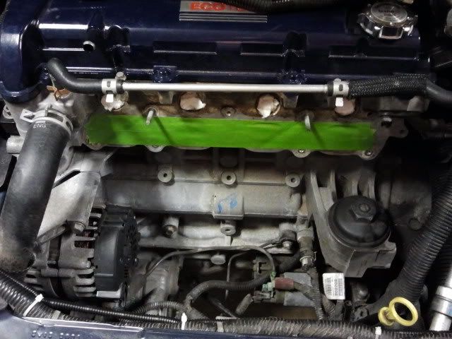

make sure you have the seal for the bypass.It's green and goes in the circle part on your intake manifold.I cant see it in the pic,
