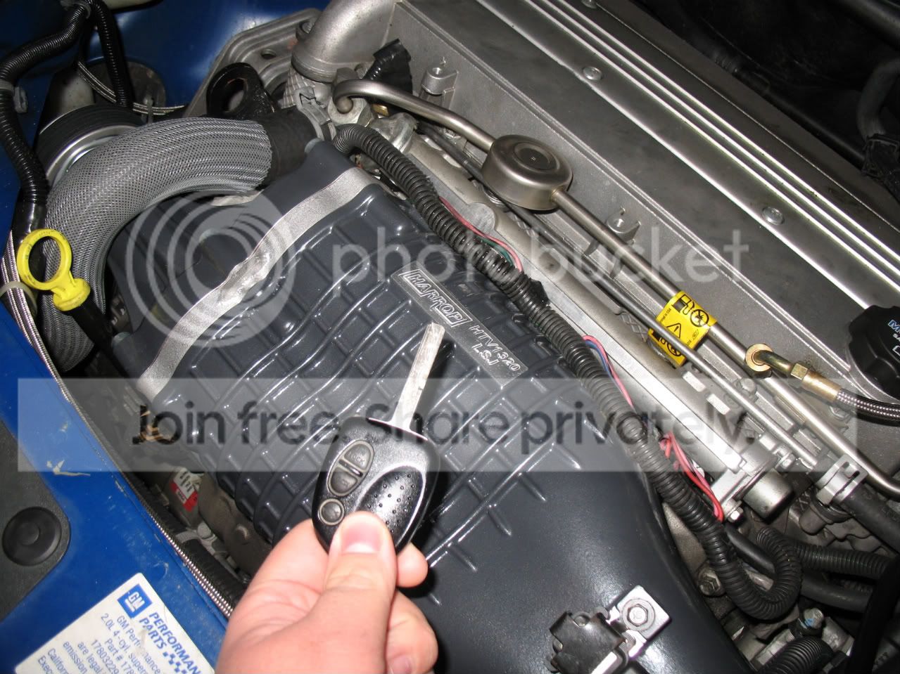

Saw this blower of FAIL tonight, NAWT impressed.
Has a pulley the size of a harmonic balancer on it.
Weaksauce
Old Mar 21, 2008 | 01:35 AM
  #757

Originally Posted by SK360
Saw this blower of FAIL tonight, not impressed.
Weaksauce
diaf.

GTO Key Owns Brand New TVS with Harmonic Balancer Pulley... Story @ 11.
