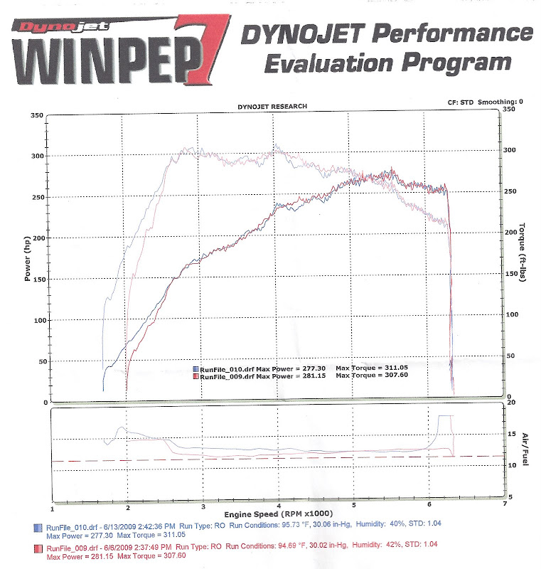

Originally Posted by drewbroo
I tiny bit of a gain
Vids up in a bit
Why is the smoothing on 0 instead of 5? That would account for the graph reading 5whp/5+wtq high across the rpm range.
I ordered a 2nd ecu and the cortex for my hhr ss. it should be here this week, got it from autoacessory.com for $356 then they pricematched it to $341 plus the 8% bing cashback for an out the door price of $313.72 for the cortex. not too shabby.
It didn't make that much of a difference, but were different dyno runs, I decided I wanted to do them without smoothing for now on to see where it peaks at. There was a -2.7WHP diff with smoothing on the 281whp run. I can get the smoothed graphs when I go back friday. But all the newer graphs will be without smoothing.

if you do not have it already, download winpep 7 (free) and ask your dyno guy to burn your files to cd, then you can take the data from your runs and stick them into a chart in excel and see exactly what you are making at all rpms and it is really easy to read.
