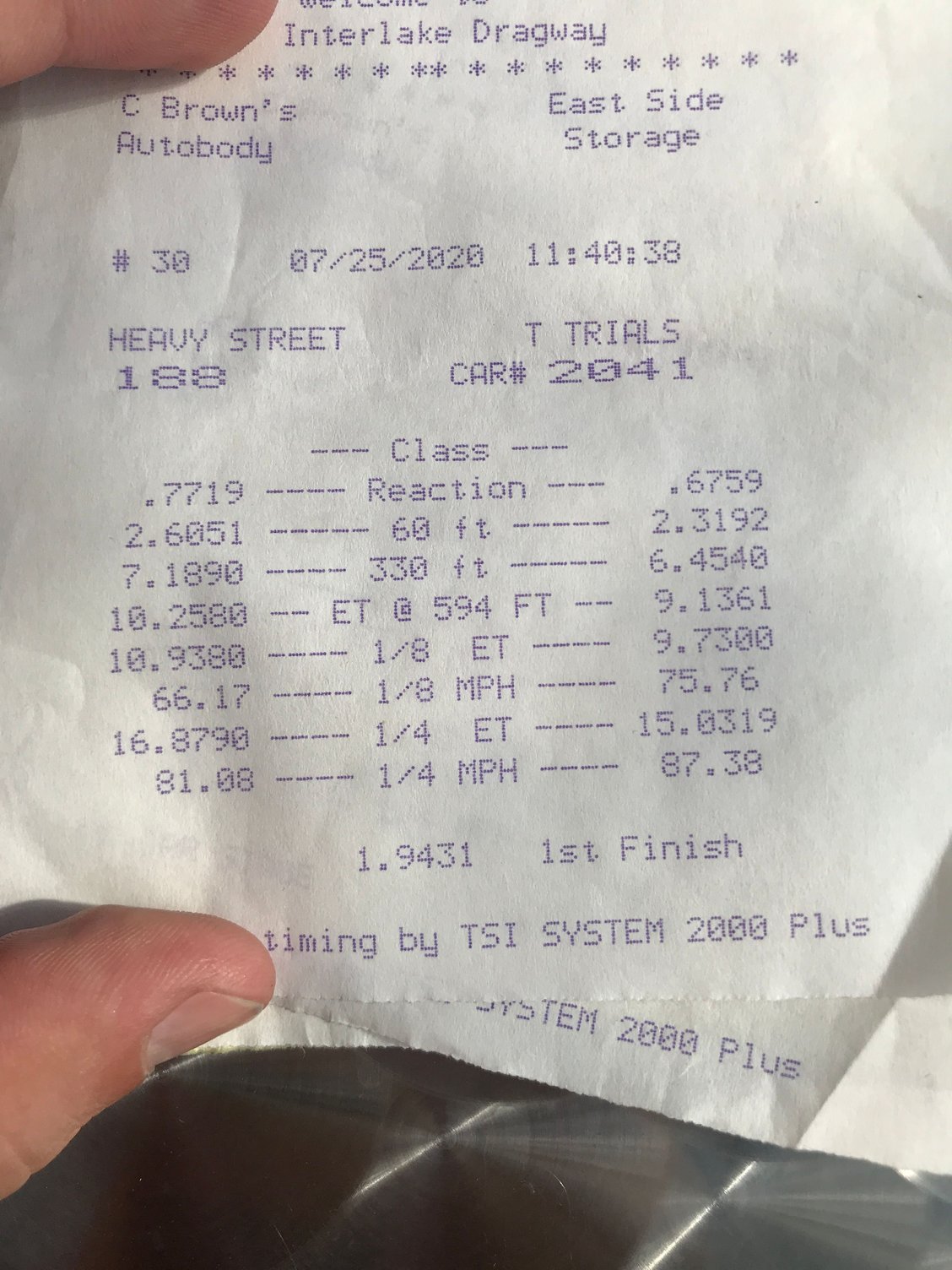

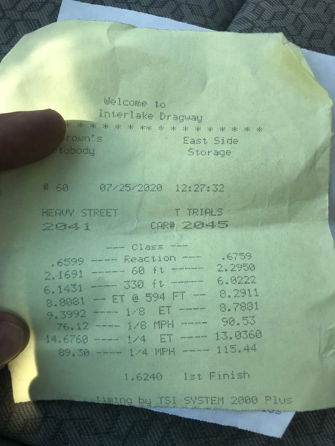

Well not as good as I though 14.67 and 89mph. I ran 15.09 at 89mph last year. Granted it was about 10C when I ran last year and it was 30C today with 70% humidity.. Definitely going to try again soon. Took me a few tries to break 14s car was loosing traction off the line found 20psi on the tires worked best.. did my first burnout! And then about 3 more. Had a blast was a great feeling to break below 14.7 without a foul!

You're not gaining very much mph on the back half, and you should be. I'd guess/bet that it's from very bad heatsoak. Are you sure your intercooler pump is working? Checked or confirmed fluid flow in your intercooler setup?
An interesting mix of parts in your sig. If you have all that and are spraying meth... I have to think something is wrong. Even without the meth... your back half is what's killing your time. Reminds me of when my I/C pump died.
EDIT: For reference, my S5 gains 20 mph on the back half (1/8 to 1/4). The car you were racing gain 25 mph; which I think is about what my LSJ picked up with GM Stg2 and a 2.8" pulley. Even the guy with the 2.4L that you raced picked up 15 mph. You picked up 12.
To reinforce my point, your quarter mile MPH is barely better than some of the other 2.2's on the drag list that are two full seconds slower; IonNinja ran a slower time, but with a half dozen more mph: https://www.cobaltss.net/forums/drag...thread-285886/

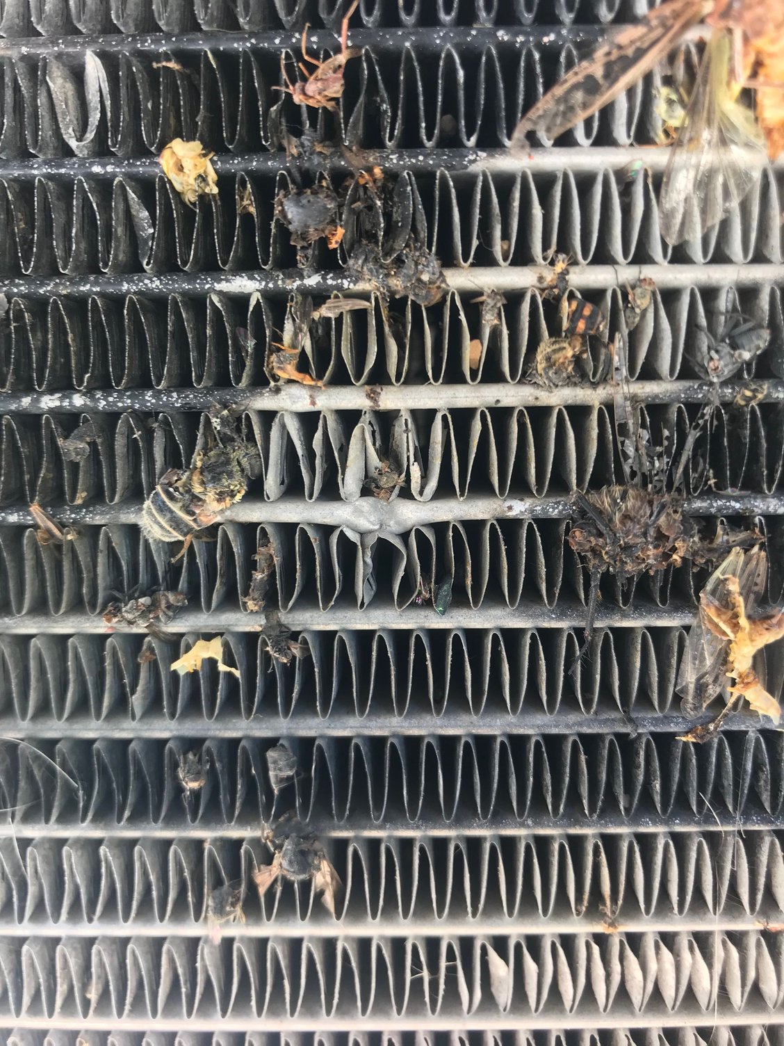

the engine was horribly heat soaked you could’ve cooked meat on the valve cover. Supercharger was Ice cold all day.
I’ll do some testing with my pump. It does make a weird growling noise with key on, but seems to be moving coolant looking at the option b tank. Would orientation matter at all? I have the pump taking fluid from The out on my S3 heat exchanger Going to the in on the dual pass endplate
Maybe my lsj he in/ out tubes are a bit pinched slowing down the flow? My s3he is starting to get damaged from bugs on the highway, might be worth a shot switching to a griffin or stealth all together

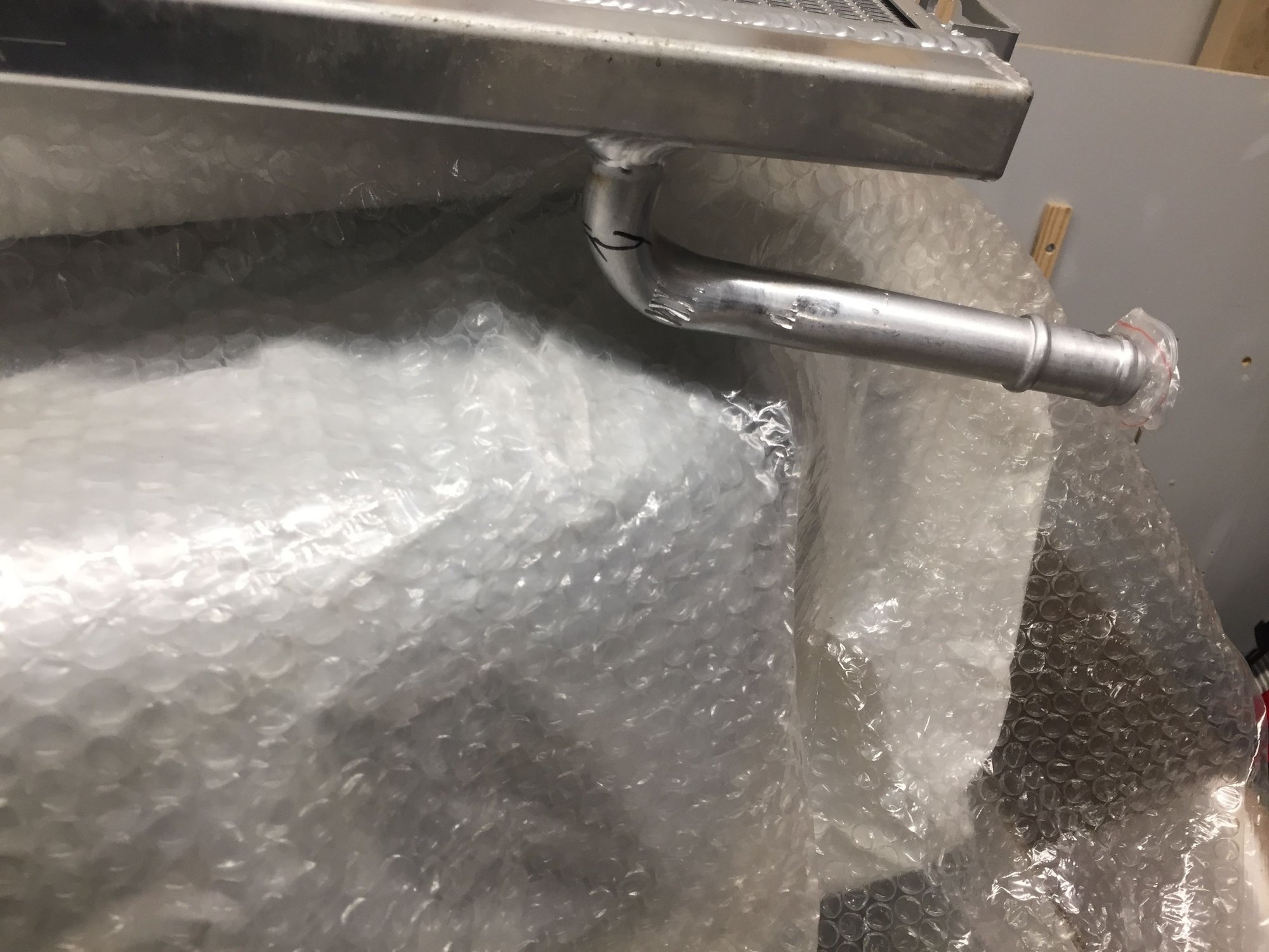

Going out of the intake manifold, my option b meets up with a Y fitting goes straight into the LSJHE, then into my S3HE then to the pump, then to the in on the manifold.
putting my hands on the hose before and after the pump, squeezing the hose, I can feel coolant moving quickly around my fingers. Option b air line is moving some coolant so I would think the whole system is pushing coolant..

Really need to put a window screen on the lower grille Or something

Well its definitely not pretty, but I figured out how/ where to bend the tubes. Hopefully should have it mounted now by the end of the day ..
Could this do it maybe? The tubes still flow but they are a bit pinched..
Whole time I was at the strip coolant temps were under 87. Kept the car off pushed it when possible. Funny both my 14.7s were hotlaps.
On the drive home I left at about 80C and it climbed to 94 out of nowhere, took an hour to fall from 94 to 91 on the highway which is unusual.
Normally coolant temp is 87-89 max. 91 is a blue moon.
