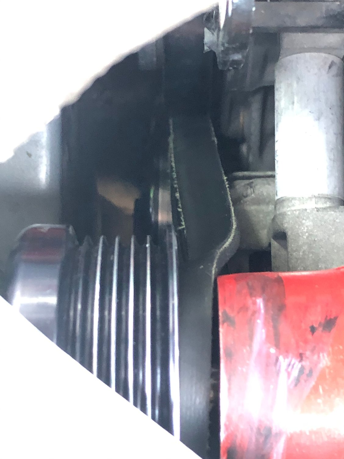

Well this morning I noticed my battery light came on and behold, my supercharger decided it didn't wanna wear a belt this morning and spit it's pulley out.
Not sure If I can just press it back in or what lol,

Old Jul 2, 2021 | 11:52 AM

Red Loctite it back on and we shall see if it stays
Fingers crossed my brotha. Do you think it might be time to switch to a complete LSJ Belt system? That way you hopefully won't have anymore issues with the belts slipping off and doing damage.
Old Jul 2, 2021 | 06:41 PM
  #822
G5ALIVE's Avatar
Joined: 07-04-18
Posts: 967
Likes: 139
From: Oak Lake
Next time I promise lol.
it would definitely help. I haven’t been to great aligning my belt properly, to my understanding a double sided LSJ belt and drive system would solve that problem very easily.
i assume the belt was used misaligned for too long, it wore over time, got pulled towards the supercharger, jumped, fell under the pulley and pulled the modular hub out.
it’s in there now though, should hold lol..
