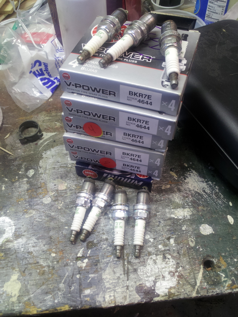

josh. this is what i've gone through since coming home from CED. minus the box on the bottom and three on top.
6 sets. plus whats in the car now lol
I have a pile of used spark plugs laying around like that. i just go ahead and change mine every oil change which is about every 2 months. I went to a parts store here and just bought a case a few months ago.
that picture is just one and a half month's worth though
